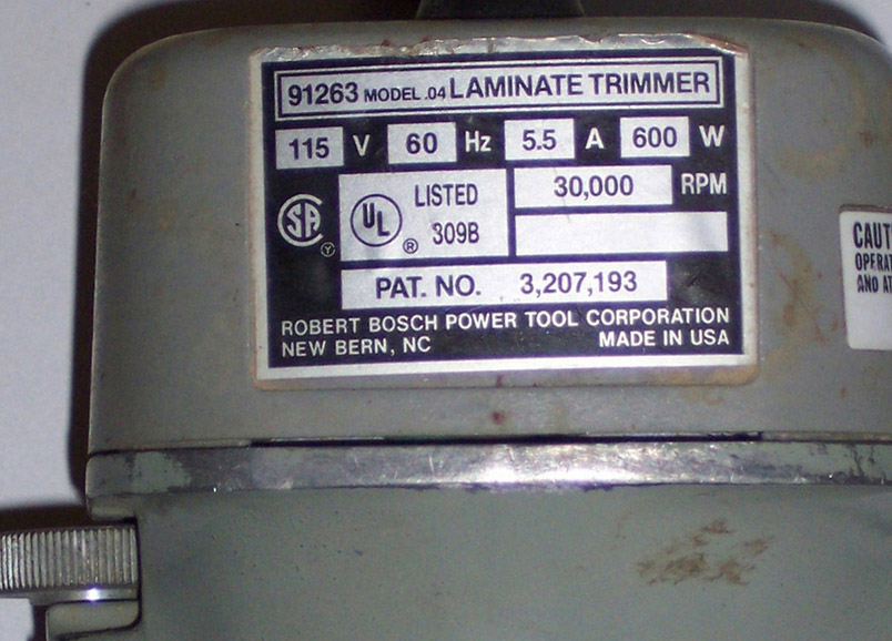

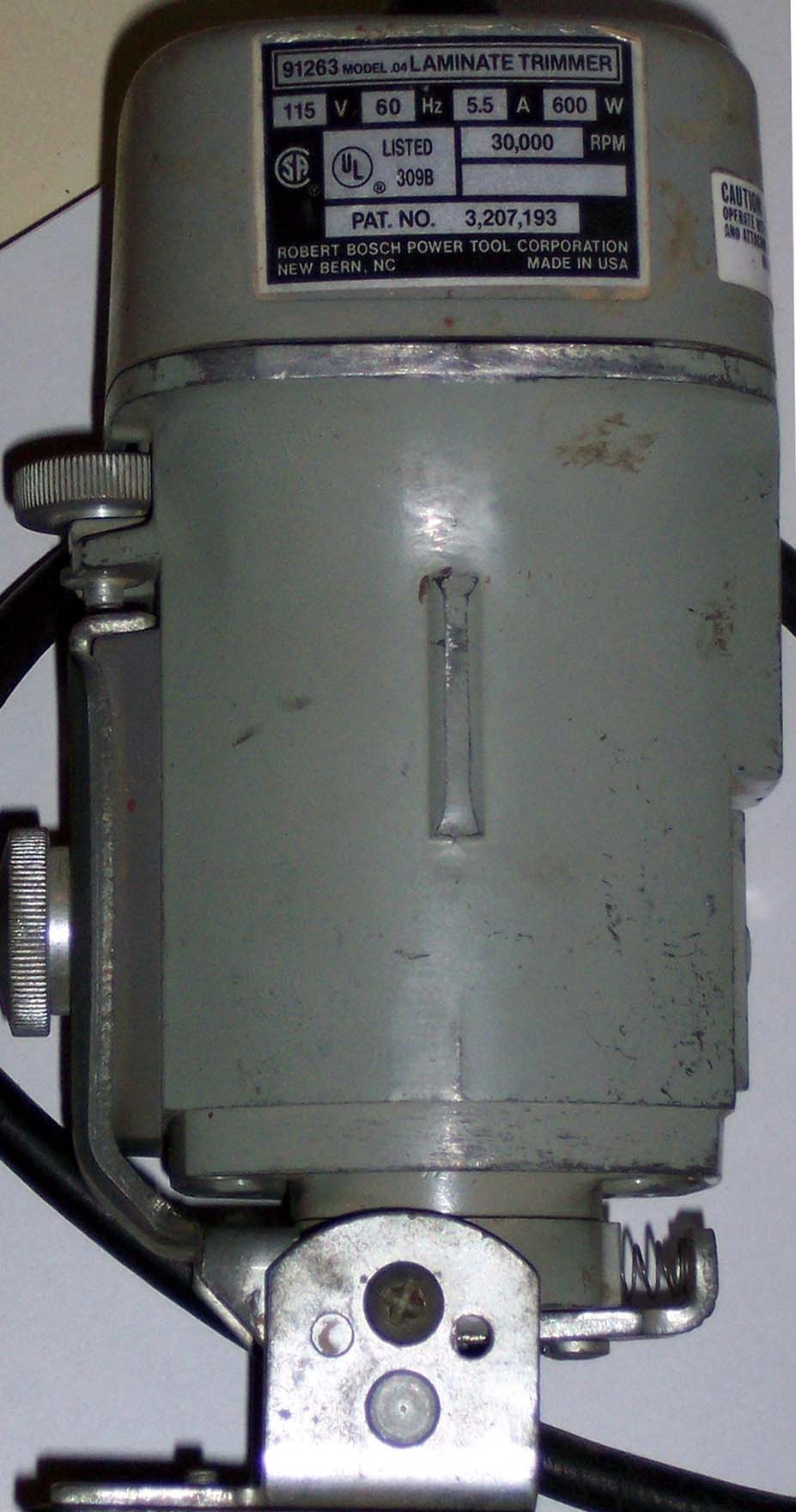

While we are discussing collets..... Are all collets the same? I have an older Bosch laminate trimmer that they don't have any information and or parts for. So.... can I use another Bosch collet?

[QUOTE=Aoibeann] While we are discussing collets..... Are all collets the same? I have an older Bosch laminate trimmer that they don't have any information and or parts for. So.... can I use another Bosch collet?[/QUOTE] That should not be a problem as long as it seats in all the way and you can tighten the bit firmly.

lillian, all collets are not the same just because they come from the same manufacturer.
if the lock nut taper does not mate correctly with the collet taper, if the collet is too long for the arbor, etc., flying router bits are a distinct possibility. they can do a lot of damage at 20000+rpm.
who did you try for a new collet, the local big box? i found bosch usa very helpful in the past getting collets for older machines. try them direct.crazymanmichael38967.040474537

[QUOTE=crazymanmichael] lillian, all collets are not the same just because they come from the same manufacturer.
who did you try for a new collet, the local big box? i found bosch usa very helpful in the past getting collets for older machines. try them direct.[/QUOTE]
Lillian,
Crazymanmichael is right. I somehow thought you were talking about collet adapters, not collets. Please listen to Crazymanmichael. With routers, you should stick with one made specifically for your model.

Michael, I contacted Bosch and was informated that they haven't dealt with Stanley products for over 20 years and they do not have information or parts for my router. That made me tilt my head a bit. Stanley is no where on the router. Bosch is the only name I found.
It is really a shame. Its solidly built, metal body, works beautifully. Oh well. I'll figure out something to so with it I guess.Aoibeann38967.2977430556
PostPosted: Wed Sep 06, 2006 10:31 pm
lillian, have you lost the collet, or is it worn out, or what. is it the little stanley with the domed top on the cylinder? i have seen them come up on ebay from time to time.

Michael, I bought this one off Ebay. Didn't look to see if there was a collet, just assume there was 'cuz the seller said everything was there, great working condition, money back, etc. Plugged it in to check that it did work and then pack it away to move. Since a picture is worth a thousand words....
Dang! Photoshop said that they were only an inch by a little more than an inch. They're huge! I have to remember that.Aoibeann38968.0015625
